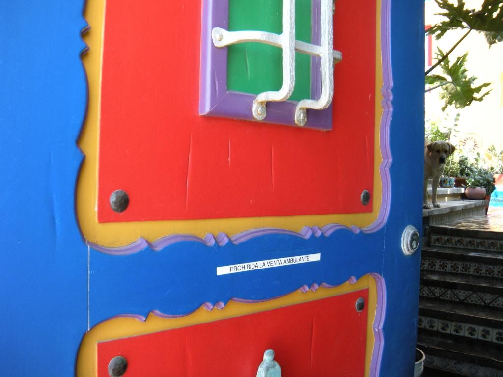

I don't know if oil-based paint products hold up better or worse in this harsh environment for wood. What I do know is my dogs are always the color I am painting that day- so water based works for us.
Minwax colored stain with Polyurethane sealer over it (door interior)
Behr (Home Depot brand) exterior paint with Polyurethane sealer (exterior). Note how the daily sun separates the wood at the joints over time. I fill them and then re-paint.

Is this your door, Woooosh? It's amazing! I'm drooling.
Old 03-08-13, 01:05 PM   #10
Default Re: "Encino" Hardwood Exterior Door Finishes
Thanks. Yes it is. Alonzo's cousin made it for us. Sadly many of the craftsman like him have closed their shops for lack of business. He's now a butcher but still does projects when he can get the work.
My dogs drool on it all the time, and worse.
