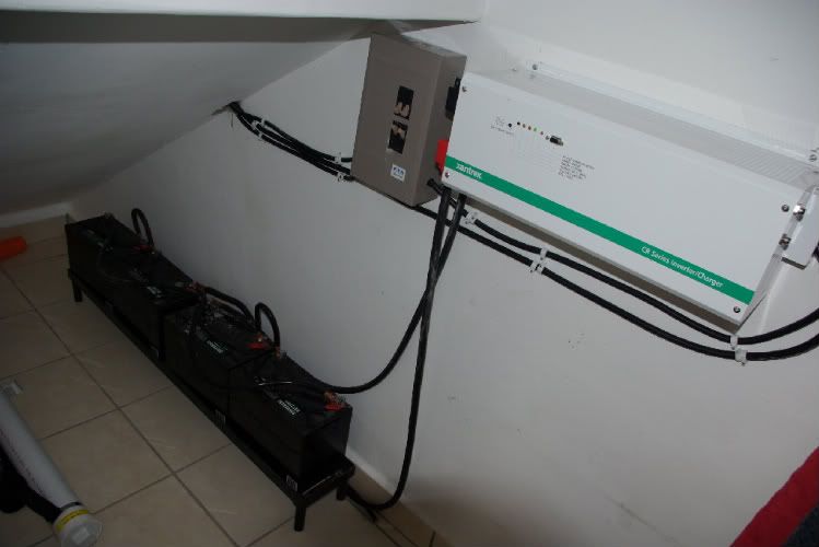

![]() We have a condo in Nicaragua where the power goes out often during the rainy season thunderstorms. We needed something so we could at least have ceiling fans, a few lights and keep the fridge going when the power goes out. This is an inverter/charger. It connects to the domestic AC. While the power is on, it keeps the batteries charged, then when power goes out, it automatically switches over to battery power and converts the 12 to 120V. When the power goes out you never even notice the changeover. When power is restored it automatically switches back and begins recharging the batteries. Waaaaaaaay less expensive than using solar panels if all you want is backup power. |
